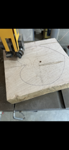

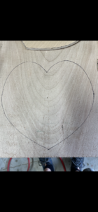

1. Determine the size heart you want to make, with me this was determined by the size of the wood I had to work with. I get free drops of 8/4-10/4 walnut, cherry, oak, and maple from a local company.

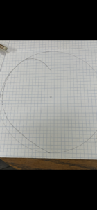

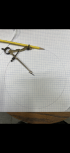

2. Once you determine the size draw a circle on paper, I use graph paper, the size of the heart. The CENTER POINT of the circle is very important as you will see later.

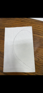

3. Draw half a heart in one side of the circle and fold the paper on the centerline of the circle and cut the shape out.

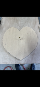

4. The center hole on the circle can be used to hold the heart in place with a small nail on your pattern board and trace the heart out. Be sure the center hole is transferred to the pattern.
THE CENTER HOLE MUST BE USED AS THE MOUNTING POINT. I use a worm screw but you can, depending on the thickness of your wood use a forstner bit and drill a small depth for the initial mounting.
5. The center hole will look as though it is not centered but just remember it was the center of the circle. I drill all my worm screw holes at one time and usually make 8-15 hearts at one time.

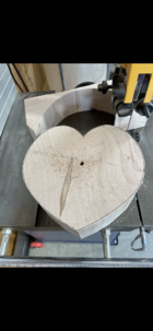

6. I then take all of the blocks to the bandsaw and 3 cuts is all it takes to bandsaw the shape. Don’t worry if you get a little off on your bandsaw cut, just try to stay on the outside of the line.

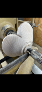

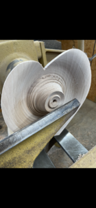

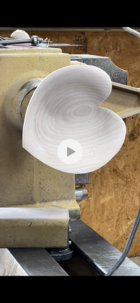

7. I mount on a worm screw and turn all the backs at one time. You can use a mortise if you so choose. The second important thing is DO NOT touch the outside shape of the heart with bowl gouge or any other tool. This will be addressed in the final process.

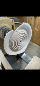

I start the cut similar to an ogee curve so I never touch the outside shape of the heart. I leave the edge of the heart usually 1/8” -1/4” depending on how flat the face is and how much I will need to take off to get it flat when it is reversed.
I use a tenon sometimes but also use a mortise 75% of the time on the bottom, again this is determined by the thickness of the blank and the mood I’m in that day😁.

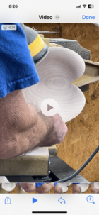

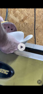

9. This is where you can even out the shape and take the bandsaw lines out. I leave the heart on the lathe and use a random orbital sander to smooth out the edge of the heart. I rotate the piece by hand and depending on the bandsaw marks use 180or 220 grit. The top part of the heart where the lobs come together is sanded by hand.
10. Once sanded on the lather I remove the heart, set it on the lathe bed, use my fingers to feel the shape and visually look to see if it is uniform. If not I touch by hand sanding or using the random orbital.
Once satisfied I take 220 or 320 to knock down the sharp edges.

Oh, I forgot: while the piece is still in the screw chuck or the scroll chuck, I find it easier to do the edges and final smoothing if I take it off the lathe - my old back doesn't have to bend over so much! I use this carving and finishing post from Best Wood Tools. You can fasten a chuck, mandrel, or dedicated screw chuck to the threads and easily adjust the axial angle and rotation.

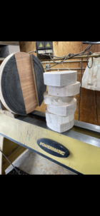

Especially nice when a kid want's to make something - this girl made a present for her friend! Her first try! (with a little guidance.)
