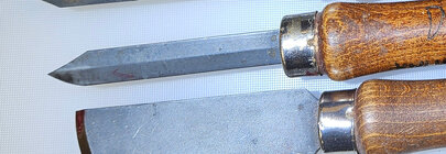

I was looking at some old Craftsman tools and the finish on the steel looked like orange peel paint or a rusted tool that was painted black. Then I looked at fleebay and all the sets looked that way. There must be a reason Craftsman lathe tools were finished that way. Why?
I pulled out all of my old HSS Craftsman tools. While the sides of the tools are not polished, they don't have the orange-peal surfaces you showed. I couldn't find the spindle roughing gouge, prob gave it away.
Could some over-zealous worker have had too much fun spraying? Is it a coating that will scrape off?

Like this. Many sets of the HSS look this way.
