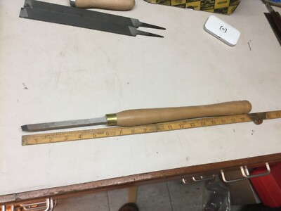

How often do you use a Bedan
I have seen and been at Escoulen's demos and he uses a square bedan.
Did he specifically say the tool was Square or were you close enough to see the shape up close?
As always though, it’s quite possible some turners use a square section tool and legitimately call it a Bedan. Over here at least though, a square section tool is normally just called a parting tool, which may have a single or double bevel.
Pascal Oudet says here that the Bedan can be either shape:
I don’t see any advantage to a square shape, apart from ease of manufacture, but as I admitted earlier, I couldn’t get on with my Robert Sorby Bedan.

I have a Thompson bedan. I use it turning mortise on the foot of green turning. It's nice to have a fixed angle with a set start to always get the dovetail right. It makes the cut consistent and only takes a moment.

I think it was in 2010 at the Hartford, CT AAW Symposium that I not only saw Escoulen's bedan I actually held it. It was square. I actually tried many many times to get Doug Thompson to make a bedan, so much so that he really got mad at me. So I started asking customers to ask Doug if he makes a bedan. 🤣

If you want a Square Bedan just buy some off the shelf square section HSS?
At the Rocky Mountain symposium, I'm pretty sure the French contingent (Yann Marot, Laurent Niclot in 2023, Jean-Francois Escoulen in 2024) said a rectangular cross section is French and a trapezoidal cross section is British. Sorby would appear to agree.
Bedan sounds French to me. The two other manufacturers I linked to both call the tool a “French Bedan”.
Edit: On the page I linked to earlier: “Bedan comes from the French word "bédane" (duck beak, as duck is anas in Latin).”
M42, 3/8" bedan from Carter and Son. Available with or without a handle, $99 without. An M42 bedan, ought to last about 200 years...

There is only one vendor selling M42 tools that has my total trust and that is D-Way tools. And by the way a square 3/8" bedan from Thompson is $75.
