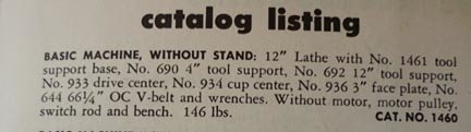

Dec 5, 2015
751
364
Seattle, WA
Found out what this is!!! In Ada Ohio was a gentleman by the name of Harold Barker. The auction was in Wapakoneta Ohio which is only a stones throw from Ada This is one of 700 lathes he built. I got reference material from a gentleman on OWWM. Spot on even down To the banjo.
That explains why the engineering on the wooden cabinet does not match the apparent quality of the lathe itself. Back in the day a good many lathes were sold without stand and motor. Shown is an ad for the 1460 Delta which was a very common lathe.
12,899
5,188
The spindle is 1 1/4x8
I would double-check that measurement before buying a chuck or faceplate. My calibrated eyeball is telling me it is 1 X 8. For any lathe of that vintage and size, the spindle threads would very likely be 1" diameter and 8 TPI or smaller.
