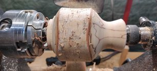

3DCDF8EA-3512-4CCE-9903-C89000590520.jpegA neighbor couple has asked me if I could do something with these pieces of magnolia that broke out of their tree a few years ago. They have been sitting in the garage drying, and are now fully dry, and have a few checks, but none too deep. I think I can get some small bowl blanks from them, but I wonder if anyone has any other creative ideas. Both pieces are 16” long, and about 7 1/2”x 5 1/2” in diameter. The significance is that they were married under the tree, and would love something to commemorate their wedding. I’ve been thinking along the lines of a goblet, or perhaps candlesticks. I’d love to hear if folks have other thoughts before I dig into it. Thanks!

These are all awesome ideas! Thanks so much everyone for these terrific suggestions! I hope to start working on this in the next day or so. Don, you raise an interesting question about how soft this may be. I’ll do a small test piece, maybe like Al’s seed jars or Sherry’s vase (lovely!) and see if I can get a clean finish ing cut on it. I’ll keep you posted.

I like your natural edge bowl Marc. I started playing with it today. I cut a six inch piece off one of the logs. Was happy to find that it was dry through and through, and no rot. Very light weight but if I used very sharp tools, got no, or very little tear out. I started just with a simple bowl to see how it turned. This one is 5 1/2” in diameter.D6DE7AC9-5EDC-49BE-967A-9365AA0EB020.jpeg Here it is before any finish. I find the grain attractive.

Here (in the foreground) is today’s effort, version 2.0. I think a nice marriage commemoration may be a (slightly mismatched) pair. Still to be finished and buffed, but I’m getting there.
Edited: As Gerald noted, and Brian said above: “the white-ish wood turned grey quite quickly as it was left out to dry and oxidize.” It is a disappointment that the color of the wood is pretty bland/grey. I’m hoping a buff will add a bit of depth.
