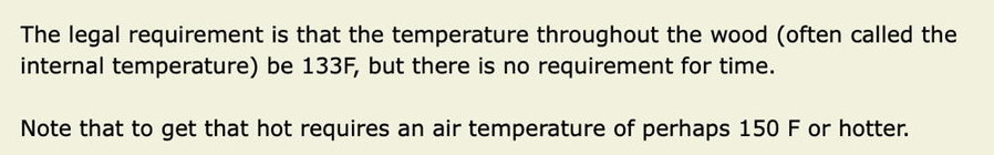

If you find life in the wood (I doubt it) this is the requirement to sanitize wood, it kills all of what's in there.
Thinner wood will get to that temp much quicker than whole logs of course.
