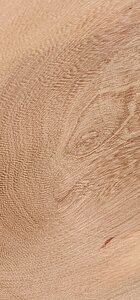

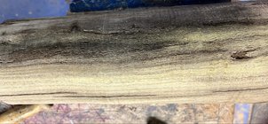

Hi
I've just turned a nice piece, but I still wonder what wood it is, usually I'm not bad in wood, I that it was Ash, but friend who give it to me thought it was cherry, but I was still sure it was ash, it's still a hard wood like ash.
But after tuning my peace, and I'm in work on another with the same wood, but the wood is really to dark for the colour, but the end grain looks like ash, but too brown and colourful for that. You'll see without any finish and for the turned one, only shellac.
I'm including photos for my big piece, it's 15 in wide, with brass insertions.
Thanks for your help

Black locust for me too. It starts out greenish, and goes amber as it gets air and sun light. Like Tim said, UV light will make it glow. It is very hard!

I'm not going by the color, but by the grain and look of the wood, Black Locust does also change color when it is out in the light and air (more red).
Anyway it still looks like Black Locust to me

Try fuming a piece with ammonia - black locust will react by turning a very dark black/green color for rye spring wood and leaving the other unaffected- it can be a striking look. I’ve never seen it on anything but black locust.

That end grain looks like elm or hackberry. They have that end grain pattern. I'm not sure what other woods do (no domestic hardwoods that I know of).
Also, it doesn't look like any locust I have around here.

If you can’t find ammonia, just use a steel wool and vinegar solution to garner the same type of reaction. All about the tannins.
I don’t believe it is ash though. It has the feather-like grain-pattern I’ve seen most commonly in Black Locust. That’s my guess alongside others.
