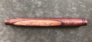

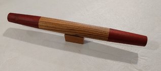

I turned this with different wood type handles. Main body is 10" and handles ~5+" so OAL is 20+" Center Diameter 1-7/8" tapers to 1-3/8" ends. Different woods allow me lots of combinations. This is a Zebra wood middle with Paduk ends. Usually I use Black Walnut for 'handles', but Purple Heart makes as nice look also. I hope all my picture shows...

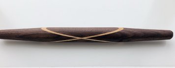

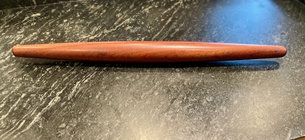

This is my first time to post, just joined AAW in Dec, been turning about a year. Wanted to make French rolling pin for nephew’s bday today so used piece of walnut had stacked in corner. It’s 16” x 1.75”, used wire for lines & texturizing tool between lines. Used Tried & True Original for finish, 5 coats, friction between coats.94323798-A51F-47DC-81D1-A331CEDF6E2F.jpeg

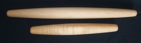

I've been making these for a few years. Some customers want the longer ones, some want the shorter ones.
These are intended to be used, not showpieces. Made from eastern hard maple. 1-5/8 x 18 and 1-1/2x12.
A lot of fiddling around getting the curve constant and equal on both sides, quite time consuming.

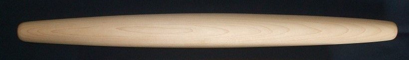

I've been making these for a few years. Mine are intended to be used, not to be showpieces. Made from eastern hard maple. 1-5/8 x 18.
A lot of fiddling around getting the curve constant from end to end and equal on both sides, measuring and trimming, measuring and trimming over and over, quite time consuming.
Then I got a Vega duplicator. First time I used it for rolling pins, I made 30 in one day.

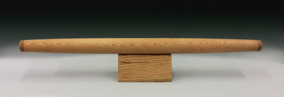

23 inch French rolling pin. Centre is 8 inches is 1 5/8" tapered to 1 1/8 inch at the ends. Timber used is recycled Douglas fir from the Quaker Oats flour mill built in Saskatoon, Saskatchewan, Canada in 1909. I t was demolished in 2015. A special thank you to Michael Hosaluk for this piece of timber. It is finished with butcher block oil.0605AF20-B75B-449C-AB82-31E1A1D25EE9.jpeg

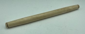

Here is my entry. Turned it from a piece of hardwood I had laying around. It is 21.2 inches long. From the middle to six inches right and left of the middle... it is flat and 1.42 inches wide. It tapers down to 0.92 inches on both ends. After turning it and doing the initial sanding .. I used sanding sealer to seal it and then sanded it to 220 grit. I read that if you sand it any finer... the flour won't stick...and "they" say pastry chefs want flour to adhere to the pin when rolling out the dough....I'm a turner not a chef! And I don't know who "they" are. ;)
