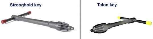

L Shaped Chuck Key
Anyone know where a L shaped chuck key for a Stronghold chuck can be purchased?
Better get it from ONEWAY if you need a new key. They may know of L shaped keys
CAUTION
STRONG HOLD KEY is oneway’s one failure in precision. We have 3 strong hold chucks and the three keys are not interchangeable. One key won’t even pass through the hole in another chuck.
All keys have slightly different teeth. So it is likely the scrolls are threaded slightly differently as well.
I’m not aware of L shaped keys but would likely have the same issue
CAUTION

My first Oneway Stronghold chuck was purchased when I got my Woodfast lathe in 1992. The chuck key for this one doesn't fit the three subsequent Stronghold chucks I purchased later on.....all after 2000, I believe. The later three all have the same chuck key.
Why do you want an L-shaped chuck key ... more leverage? If so, why don't you just slide the rod to either end? You can epoxy or tack weld in place if you think that is necessary.
So I can mount bowls with a mortise on the inside. Unless the bowl is shallow a L shaped key is needed to tighten the chuck.
I currently do this with my square key chucks using a ratchet wrench.
I do this fairly often and find that, depending on the depth of the in side recess, the key doesn’t have access. Please don’t tell anyone, but I keep a large, flat bladed screwdriver handy and use it as a lever to turn the pinion gear.. It doesn’t take a lot force to secure even a large bowl securely, and once the tenon is trued,, or outside finish cuts done, I’m generally done. I. Have thought about devising a universal joint similar to those I’ve seen on socket wrench extensions…but haven’t taken the time so far.
Steve, if I had to do this, I would get a chuck ket from Oneway and cut the gear end off, then weld the bar on top of the gear end at right angle, you will not need much room to insert and remove the head.
Of course you could do it another way, leave a stub from the chuck key (not weld the head on) sticking up above the chuck body, file the stub to a hex shape, then you can use a flat ratchet wrench to tighten or loosen the chuck (faster than the other way)

Good idea Leo. Hate to cut up a chuck key but looking like that is the only way.

Also, whatever solution you choose, your design should let you apply some downward force on the pinion to reduce its natural tendency to rise when you apply torque. Otherwise, there could be rounding-over wear on the gear teeth as the pinion toe-end journal pin jumps out of its socket.

That makes sense now. The outer shroud makes for a problem because the key has to stick down through the hole and into the ring gear.
Option 1 would be to get an extra key, heat the shank, and bend it over. Cut off the extra length you don't want. An above suggestion of welding on a handle would work also.
