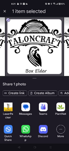

Once a design is done, how did you get the image in to the laser program?
There are various ways, but I do it from my Android phone by making sure my image is stored to Google Photos (not google drive) and then sync to my cell phone, then from within the photos app on phone I select the picture and hit "Share" and in the options to share with, I share it to the Laserpecker app , sharing to the app causes it to launch and from there it is just a matter of setting up your options, previews, etc. (of course helps to have the LP1 powered up and ready to bluetooth connect to phone)

I have an Android phone and use Google Photos. I upload all my images to Google Photos. Then I just go select a photo in Google Photos on my phone, and share it to the LP.
