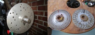

Sorry Tim I missed your post. But here it is the disc on the head stock is my indexing system it consists of three discs covering a range of 15-90 indexs,the disc on the lathe is a special 5,7,9,11. Banjo has a 12" swing, has a three step pulley system although I am going to 220v 2hp three phase variable speed with remote. The lathe sits on a pine stand with a Douglas Fir bed 12x3", pine is 6x2" . Three beds to allow the Banjo to move around as the main bed is around 30"
