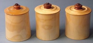

Several years ago we had a demonstrator at the club in Fargo Moorhead called Minndak Woodturners do a demo on traditional scandinavian work mostly about shrink boxes. I made one in the traditional oval form but then I switched to round and finish turning on the powered lathe. The material I used was the live fresh cut native birch from the surrounding woods and found that it is a flawless methode. The bottoms never loosen and the sides never crack.
The above shrink canisters/box/pot are an example of some that I have done. The blotchy look is from the oxidation from drying that only partially is removed in the finish turning. The line near the bottom on the middle one is not a crack but rather a sap streak.
Note i tried ash once and it shrunk so much that a large crack appeared but the birch never have that problem. Notice the one on the left that started as a straight cylinder but no cracking occurred during drying.
