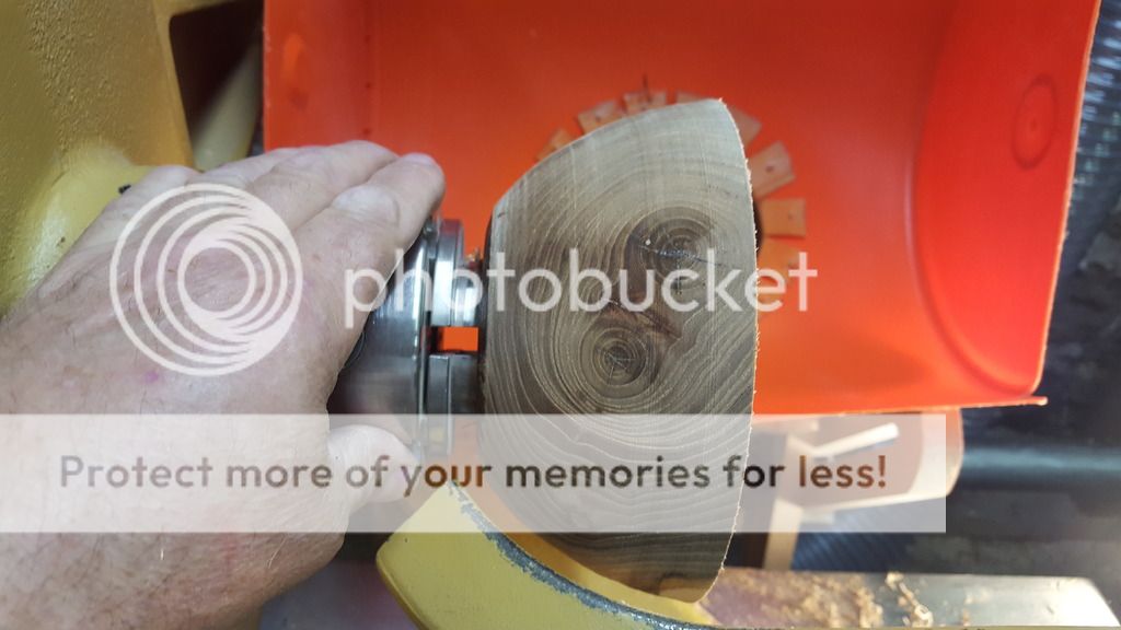

Finally and I mean Bloody Stinkin' Finally. I got my DC all hooked up and finally my lower back is not killing me so much I can't stand in place I hurt it last may. First time I could stride like a person was mid September. Anyway, enough whining.
An elm fell (Siberian Elm) from a windstorm a while back and I just left it - it's still alive and green. This is one of the many bowls I expect to harvest from it.
http://i1002.photobucket.com/albums...tle elm bowls/20161018_162200_zps8mqiwtdh.jpg
http://i1002.photobucket.com/albums...tle elm bowls/20161018_162155_zpsy9hxcnwi.jpg
http://i1002.photobucket.com/albums...tle elm bowls/20161018_162144_zpsbemp6cei.jpg
It's still rough.
I didn't give a lot of thought to this one. I just grabbed a hunk of log some 8 or 10 inches diameter and split it and chucked it. It's still green and I'm really close to finished dimension. I got it wrapped in plastic wrap just playing around to see what happens overnight.
The knots are not being my friends. The only siberian elm I've chucked up before has been dry and man oh man that lumber is dusty as all get out. So this'll be a learning experience.
I've worked a lot of this local Siberian Elm. Ht dries like a trooper very little warping and checking machines like - - well it's really sweet - and I think is just a gorgeous wood. I made Five of these boxes fer the womin folk a while back http://s1002.photobucket.com/user/zydaco/library/The Shop/A box?sort=3&page=1

Meanwhile I chucked up another hunk of elm log and even though it's entirely unnecessary I just had to whip out that Cobra style Hollowing system I made last winter - - this is it's very first use. I found the shielded cutter head to be a tad large for this small diameter. It's made from 5/8" rod stock so it's a tad big for little work but I just had to ( lets see if I can post a You Tube video)
This was the first post if the thing.
Here I am using it for the first time
and here

Looks like there is a lot of vibration in the cutter. The tool might work better if you progressively work from rim to center in stages. Once a section is done and thin, don't go back for "one more pass". A bowl gouge. Would be quicker and easier and have a pleasing smooth flowing continuous curve from rim to center.
8,729
5,120
When you develop techniques size matters.
Some Techniques that produce results on small bowls will be disappointing on larger work.
Like Bill said a bowl gouge will leave a better surface and be much more efficient.
You can reduce vibration some on your hollowing rig by working over the tool post instead of on the edge of the tool rest.

Bowl Gouge, ok. I have Irish grind gouges. I built that Franken Hollower to compensate for my lack of skill inside the voids. I catch the tool like crazy. Sorby has a really simple rest that projects into the void maybe I'll make one of those and give the gouge another shot & pay more attention to the angle of the tool.

The tool the OP uses is better used in endgrain IMO, for sideg-rain I would use a bowl gouge
That was my thought also. Of course it can also be used on side grain hollowforms, but you need to go slower with lighter cuts to reduce vibration.

Bowl Gouge, ok. I have Irish grind gouges..... I catch the tool like crazy. .
@Raul McCai
Working with a mentor will eliminate years of frustration and advance your skills rapidly.
Catches occur when the wood can drive down onto the the tool.
Most common reasons are incorrectly ground gouge, tool rest too low, flute angled too high. Taking too big of a cut.
1. The cutting edge of the gouge must be a continuous convex curve wing end to wing end. Flat is ok.
Dip is not ok. Hold edge on a flat plasticfrom wing to wing. The edge should touch at one spot all around. If light shows between too spots grind the high spots on either side,
2. I like the tool rest set so I am cutting at center with the tool handle parallel to the floor. This enables me to cut to the bottom center of the bowl with a swing of the tool.
3. Point the flute at 3 o'clock entering the bowl. Then roll it up to 2 o'clock or maybe 1:30. This is what I do in the video. Avoid the advanced cuts with flute higher the until someone teaches them to you.
4. When you first start hollowing take smaller cuts. 1/4" -1/2 inch of wood removal per pass.
1/4" is best until you get experience and you get twice the experience with 1/4" cut as you get with 1/2" cuts. Float the bevel over the surface. Grinding the heel off the bevel helps keep the bevel on the wood and reduces bevel drag.
I recently saw a tip attributed to Glenn Lucas. Draw a line in the bottom of flute with a red sharpie.
If you can see the line while turning you are likely to get a catch.

My "gouge grind" is exactly as the grind was on my gouges that came from Tompson. I built a version of the Tormek and it does it for me.
I must confess: I got Thompson's bottoming gouge and haven't figured out how to use it. Every time I pick it up I catch it.
I've found that very small cutting tools ( 0.187" to 0.250" dia) mounted to stout shafts of 5/8"dia., tend not to catch and yet I can wast away enormous amounts of material rapidly. Well, I'm sure they catch, but the "catch" is small so it passes without notice. The tool isn't mounted on an angle (it's flat to the work) so it doesn't get driven into the work the way a gouge can when presented poorly. I grind em to cut on the sides and face.
I try to rub the bevel when I start a cut: still working on developing the proper habits. The wood Lathe is unlike pretty much every other thing in the shop. It's a whole different set of skills.

OK so I looked at your video again, #2 this time, and I might be totally wrong, but it appears to me that you are using a ring cutter that is shielded, held upside down, with your lathe turning in reverse ???, I mean clockwise facing the bowl.
Am I right ????
Am I right ????
I think you are right, Leo. I looked at them a couple more times and I also noticed in the second video that the tool shank from where it sits on the rest back to elbow is not in line with the cutting tip. So, turning in reverse and the twisting force on the shank both contribute to vibration.
Am I right ????
Yeah, I don’t know if it’s clockwise or just the video syncing…
Assuming the wood is spinning in the conventional direction, I do think:
  • The lathe speed is too fast;
  • The tool is too low (you can see this when he crosses the bottom center of the bowl);
  • The wood has visible cracks.
Raul,
The combination of speed, tool height, and increased flexing of the wood due to pith cracks is not doing you any favors. I’ve used the Pro-Forme shielded ring cutters on bowls with no problems — very much the same approach and cutting action as a bowl gouge — so I don’t think that is a big factor here. I think if you raise your cutting edge above center height you'll see great improvement. You also might want to explore a gradual hollowing of the interior so that the bulk of the wood remains while working from the rim to the center. Once you get an appropriate wall thickness you don’t revisit that section other than to lightly blend.
Am I right ????
Well no. The reason it looks upside down is an engineering /design decision I made when I built that tool. I put the screws that connect the knuckle as well as the screw that holds the hood in place under the tool so that the threads were cut in the parts of the tool that face up. So the lathe is running in the normal direction the little round carbide insert is facing up. If I ever build another, I'll use left handed threads. One flaw in this design is that the rotational force on the knuckle in normal use tends to cause the screws to come loose. To solve for this I had to add a specialty locking washer to it after the fact which meant I had to re spot face the seats 0.090" deeper. I would link you to the photobucket page where I have images of the construction pictorially but photobucket won't load today.
I'm still of two minds about the whole adjustable knuckle thing. I sort of wonder if a couple of variations of the bent bar tool might be every bit as functional as a knuckle system.
Thanks I'll look into that.
EDIT:
Raised the shielded cutter above the CL That made a real difference~!!

Hi Owen, it’s been a long time exchanging info, if you do recall that is.
I was not basing my thought on the last bit of the slowing down bowl, as yes it could be video/light syncing, but on a couple other things, the overhang of the cutter that sits on top of the shield, you can see the opening of the cutter where you can see the shavings shoot out upwards.
But maybe I’m blind, I do agree with the tool sitting too low if oriented the right way,

Cutting below center on the interior definitely not good. As far as the direction of the shavings, I have a Rolly Munro guarded cutter for my boring bar and that is the way that the shavings exit ... there's no other way that they could go. If I didn't previously mention it, the tool shank needs to be inline with the cutter tip. This is why hollowing tools have a goose-neck shape. Otherwise there is torque that goes back to whatever is holding the tool shank ... an elbow type tool in this case. Even if there is very little free play at the elbow, there is still plenty of compliance between there and the cutter tip to cause vibration. Having the tool shank inline with the cutter would effectively remove much of the torsional contribution to vibration.
Regarding cutter height, cutting exactly on the centerline is the neutral stability position and generally safe for both inside and outside.¹ Basically, you want to have the cutter height so that the wood is moving away from the edge and not tending to drive deeper. This means that on the interior of a bowl the tool needs to be on or preferably above centerline. On the exterior it would be just the opposite with the cutter at or below centerline. This is a simplified description that is easier to see with scraping tools or cutters that are horizontal. In the real world, experienced turners can make cuts that appear to disregarding Mother Nature and getting away with it. In actuality, the cuts are safe, but it takes some experience to reach the point where you can safely use the tool on the hairy edge of a massive catch. You will have that "aha moment" where you can intuitively use the tool to make nice shavings without catches².
¹ An engineer might think of it like being right on the axis of a stability diagram ... safe, but right on the edge of bad things.
² I don't have catches, I'm just practicing to show beginners how a catch happens. That's my story. :D

Bill al the foregoing showed that I wasn’t familiar with the Rolly Munro tool, as I assumed it was a ring tool, similar to a Termite tool, I just now googled “Rolly Munro woodturning tool” and saw how that tool is made and works.
Maybe I should have looked that up first, sorry for that, the other part of holding the tool too low of course still stands, it would also have the heel run into the wall, especially in a smaller turning :))
12,909
5,207
The Rolly Munro carbide cutter has a raised edge like the Hunter tools which means they are very sharp and very good at slicing wood. Without the guard they couldn't be used with a captured bar type of hollowing tool. I haven't used a Hunter tool, but I suppose that they could be used like a hook tool for hand held hollowing. I've used a hook tool enough to be barely proficient and appreciate that they aren't very forgiving. :D
Well it is sort of a ring tool; Just not hollow. I used a round carbide cutter in mine
Just not a hollow ring . The "Ring" such as it is is a raised edge on the round carbide cutter. The shavings are supposed to slip down into the circular depression in the cutter and up out of the tool. I find that wet shavings can get stuck necessitating that I clear the tool.
Fuzzy photo from the underside showing the slot used to adjust the hood

Raul looks like a well made tool, and I would consider using a tool like that in a hollow form if I ever would make one, with bowls my tools are bowl gouges and spindle gouges on spindles and endgrain turnings also.
