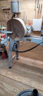

Record Power Regent. 18” swing over the bed, 39” swing outboard and will turn a 24” spindle. It has a 2 hp motor, remote pendant with all the controls and a pivoting headstock. I have had the Envoy, 16” little brother for a couple of years and am very happy. The Regent is on sale right now at Highland Woodworking for $2399
Have you found that the 250 rpm minimum on the Envoy is limiting? Seems a bit fast for starting big, unbalanced pieces.
Not a problem. I start most of the big chunks on the center pulley with a minimum of 400. I have gone down to the slow speed for the torque but never needed to go below the 250. I have put some big pieces on it and never had a problem.
