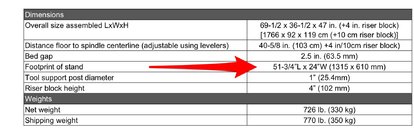

"If so, what are the dimensions of the legs installed so that I can cut out a base? Online specs say: 55.25" L x 27.25" W. Would 59” or 60” long x 29” wide safely cover for the leveling feet installed?"
From my original list of questions. Would one of you mind measuring that actual footprint so I don't cut a base too small? I'd like to have a 1" plywood base (or something better if anyone has a sturdier option) ready to put the lathe on before it arrives-just trying to cover my bases lol. Thanks again!
This is a different number - You can check the manual - might be worth a read before it arrives.
If you put a 1" base under the footprint of the lathe, what are you going to do about that difference in height between that raised base and the surrounding floor? You will be standing right in that area when turning.
I've thought about that. I plan to cut away a relief of maybe a few inches between the legs/feet of the lathe to account for my feet at the lathe. I might need to do some more measuring-hoping with the base and the risers installed, my elbows will still be about spindle height, which for me is 46".
Thanks, Al-I have bookmarked that manual. I will go with those dimensions unless someone tells me different after measuring. I read different measurements on some website, can't remember which.
