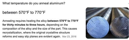

I have done a bit of metal spinning, I like to use copper as it is easy to anneal, with aluminium you need to know what kind it is, you are better of to get Dead soft aluminium, sold in craft stores and by McMaster.

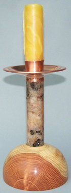

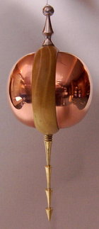

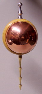

Candle holder.jpg Candle holder copper.jpg Spun and hammered copper lid.jpg Copper brass and alluminium.jpg Ornament with spinned copper.jpg
