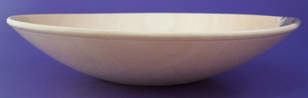

Brian blowing all the sap out/off the wood will lessen the color leaching, I never really tried that successfully, what I did try is turning a shallow bowl from just the white sapwood, so there isn't basically any sap to migrate and then oxidize.
This is that bowl and it stayed pretty white but over time even that color changed to a darker color, so to me it isn't worth the effort, I like the Walnut showing the light and dark wood, and removing most sap will give you a nicer outcome IMO .

And this is the same bowl several years later.
Love this, but even that will change.
