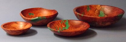

Before putting the putty into the void I would rough up the fibers to give it a mechanical bond, then after it has cured turn it smooth and under cut the surface about 1/16th" deep. The surface is then refilled with powdered mineral like turquoise.
The fill process is to first spray the surrounding wood with thinned shellac to keep the CA that will be used to solidify the mineral does not soak into the wood. the next step is to support the area in as level as possible, spread the mineral, drip CA onto it and when the CA has set smooth over with rasps. This is an example of the method used to fill worm holes in mesquite burl.
