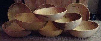

I do 20-25 inch bowls regularly. I core whenever possible. I start with a oneway 6 in faceplate attached to the blank face (future bowl hollow side) using the tailstock work the outside of the bowl blank till satisfied and turn the tenon at the same time. Ensure the center point of the tenon is well marked for later use. For blanks this large I use #5 0r #6 stronghold jaws. Turn blank around, core and wait about 1 year to finish (bummer but necessary) Realize that the bowl blank will warp ,maybe even go oval. the second turning will require rounding the tenon again hence the well marked center point I jam chuck the bowl blank with the tenon on the tailstock side re-round the tenon, reverse the blank using a chuck now and turn a bowl. Hope this is understandable and helps. Ray
Did you predrill for the center pin for the big bite? I routinely turn 18” diameter bowls and have never had one fly off the lathe with the same setup.
