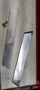

Got the idea from John Jordan.
The handle is made from ABS plastic. It's tough as nails and can be machined similar to metal. Also easy to glue. It's available on eBay in various thickness. Cost for pieces 12" square and smaller is usually less than $10 delivered to your door.
The blade is a re-purposed HSS knife cutting blade from a newspaper company. That's the reason for the holes in the blade.
I made a couple handles for similar sized steel blanks. Two halves of scrap wood with a channel routed down the middle for the steel. Before I glued the two halves together, I glued a nut into one side (under a hole) for a set screw. Then glued the halves together and turned the handle.
I made the handles a little longer than the steel so I could burry the tool in the handle for traveling.
