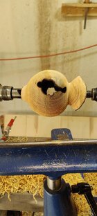

About a year ago, I posted pictures of a mulberry with a hole through the pith. Someone said, "That would make a great hollow form." Today I cut a section of that log and mounted it. I have rough turned it. Unfortunately, I probably took too much material off the bottom and now the hole is down near the bottom rather than centered. I'm curious how you HF folk would shape this at this point.
What profile would you go for here? I'm not opposed to you drawing lines on my photo. ;) I can probably turn it around if needed.
When I look at it, I see a round-bottomed form with the bottom on the left (in the drive center). There's probably room there for a tenon. Not sure about the tailstock side. That flair might make a nice top. But you might get better effect from the void by loosing most of that and just have a mostly-roundish form. Hard to judge from one picture.
Thanks, Dave. I thought about that. I think it would work to turn it around. The flare was just an artifact from shaping, but it might be usable.
Hi Kent, I agree with Dave. The spherical shape can be helped by putting a mild "neck" off the top and tapering the neck up into a relatively small hole. I visualize the neck about half as tall as the wood you have left there now at the live center end.
Plan "B" might be to turn it upside down. The neck now is where the drive center is. The base now has lots of waste wood for a faceplate, stronger and safer holding. Continue the bulbous shape of the bottom with a rather small foot to sit on the table that will give it some lift and lightness. Dont be afraid to turn it thin, just take it in stages and dont go back to the top once it is thin.
I would 2nd Dave’s & Lyles too.
If you pull the left side in a bit you will have the windows centered on a spherical shape.
I always probe the inside of hollows a bit to be sure there is no hidden soft spots where I want to hold it on the lathe.
Then you can design a foot and rim openings you like. I like a round bottom with no foot.
A sphere with a through hollow makes a nice piece with no hollowing.
You have that available too.
Can’t find a photo.
I've been thinking about this after reading your comment. I thought, why hollow it more at all (which is what you were suggesting)? I started hollowing, and it's pretty rough going with that void and my lack of a hollowing system. The wood is stable and the pith is gone. It isn't going to crack. Other than the weight and the cool factor, perhaps hollowing doesn't buy me much. The walls are about 5/8" currently.
Sounds like you’re getting there!
Interupted cut hollowing is one reason I don’t do twice turned HFs. Just a bother to hollow.
Voids make it worthwhile hollowing the interrupted surfaces.
Easier with a hollowing system. With hollows I go slowly. About 1/2 or 1/3 of the normal hollowing speed. With voids the shavings go out through the voids - a big plus. Very important to get the wall thickness at the rim and go down the wall in 1-2” increments. Need the thicker walls at the base to keep the vibration down.
If I wanted a 3/16” wall I would start that 3/16 wall from the rim when the form was around 3/4-1/2” thick and probably not hollow the bottom at all until I was forming the wall. Then form the wall in increments 1-3” then the next increment untill I’m shaping the bottom.
You are correct that your form is unlikely to crack with 5/8 thick walls.
I’ve done a half dozen spheres with a through hollow - none of them cracked.
You can get a pretty good idea of how it looks with the wall thickness you have.
If it looks good stop. Of it looks off hollow more but you sort of have to commit to a final thickness target and hollow from the rim down.
I want a really even wall thickness around the voids.
