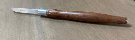

Greetings
Hello everyone,
I want to express my gratitude to all of you for your support and guidance as I continue learning, this time about scraper angles and carbide burnishers. I’m also really pleased with all the interaction and knowledge-sharing happening here.
Thanks again! As a final note, here are some pictures of my new tools—the scraper and burnisher. Now, I’m ready to dive into designing my boxes.
Happy turning!
