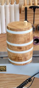

I like this. I have a urn for my wife on my to do list. Could you share the Angle and width and thickness of the staves and the finished diameter and width? My wife loves Irish Whiskey. Needless to say I will have to check with her. Sometimes what I think is cool she thinks I am out of my gourd :)
I don’t remember the angle. I never plan too far ahead. I just figured out how many would work with a good angle to cut and started cutting. I wish I would have made them thicker so the barrel would have been more rounded on the outside. I will post some measurements when I get time.

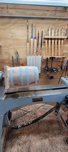

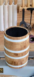

Pat I am sorry it took so long to answer your question. There are 18 staves so the angle I ripped them at was 10 degrees. They were straight not curved. They were around 1” thick and next time I will go at least 1.5” so I can get more curve on the outside. The barrel is 7.5” in diameter and 11” tall. I glued it all together and had two open ends. In order to turn it I cut one end square on my bandsaw and then glued a board on it to attach a faceplate. It seemed very sturdy but put a steady rest on it to get rid of vibration. The recess for the miliput for the metal bands I would make thinner next time. I used the standard square carbide cutter to make these and they seem a little wide.
