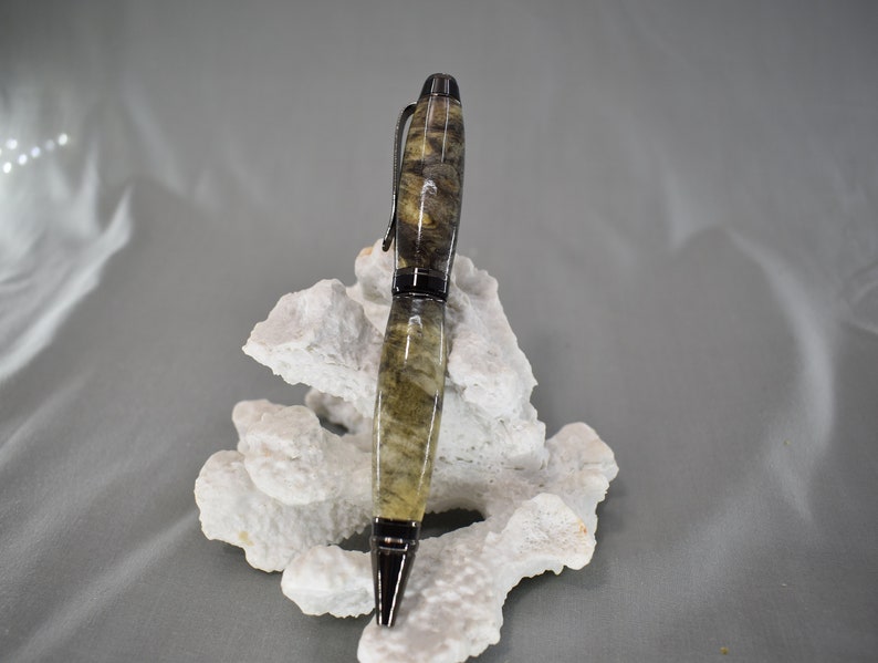

Making pens is right up my alley and have made many over the years and love doing segmented ones and also making arylic ones. I like to make my own blanks. I believe that some of the best looking woods are burls. Mother Nature does most of the work and all we do is spin thin and add components. I am a big fan of using CA as the finish of choice because it stands the test of time. It can be tricky to apply but after a few you develop your own methods. You can cut back on the shine to give it that wood feel and look at any time.
As far as pencils go, yes Pentel guts are the way to go. https://www.pentel.com/collections/pencils/products/sharp-mechanical-drafting-pencil
A couple examples of my work.
Copy of Copy of IMGP0892.JPG Copy of IMGP0441.JPG Copy of IMGP0392.JPG Copy of IMGP0135.JPG IMGP0061.JPG
