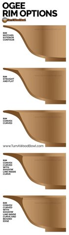

First of all, we apologize for the delay in posting the challenge. This month's challenge is to turn a bowl with an ogee curve. It is open to everyone. No embellishments; let the bowl's shape be its main focus. A quick search with Google will set you in the right direction, if you are wondering what an ogee curve is. Wikipidia says: "An ogee is the name given to objects, elements, and curves—often seen in architecture and building trades—that have been variously described as serpentine-, extended S-, or sigmoid-shaped. Wikipedia" (my grammar corrector was not happy with the Wikipidia grammar, I left it as I found it)
From a woodturning site, I found some nice drawings:
The diameter of the bowl should not exceed 10 inches.
