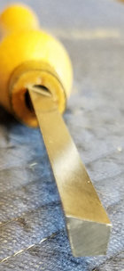

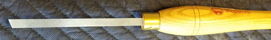

My husband and I are working with a former member's wife to sell his tools since he is no longer able to turn. We brought all the tools home and while pricing we found this odd tool. We can't identify it by name or its use and at least 3 other turners have no idea how it would be used. looking for some assistance. The handle says it is a Sorby but a search of the Sorby site does not show it.

I'm making a guess on that one. It looks like an attempt to have a shear scrape with the bottom edge flat to the tool rest.
One of my lathe tools has a diamond shaped cutting angle similar to the one shown, the handle is marked from the house of woodturning. There are several angles you can use this tool to reach into tight spots and shear scrape on the bottom recess on bowls etc.
It is one of three tools in the Shopsmith pen making set. “It is not a bedan. I bought that set when I had a Shopsmith many, many years ago. The set also included a thin parting tool and a small roughing gouge. They no longer sell that set, I still have mine. I used it as a scraper. You could also use the point for groove lines. I believe at one time Sorby had the same design.
