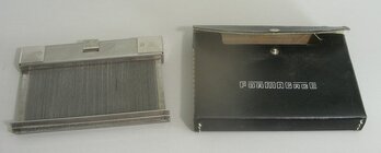

Google "contour gauge". Dirt cheap and effective. They come in plastic and metal wire styles.

Decent, but like most these days, the pins are rather large in diameter and blunt. I have two which are really nice, but neither are available any longer. I've been using a Form-a-Gage for almost 50 years. Fine pins (maybe 30/inch), secure lock. I used one in my archaeological career to do almost 5000 measured pottery drawings. All the dust and grit had no effect on it. They haven't been made for decades. Also during my archaeological career in Turkey some 20 years ago, I was given a Japanese one made of bamboo, after I shared a lot of pottery data with the Japanese project staff. The 'fingers' are very thin slivers of bamboo -- probably about 60 / inch! That is such a beautiful tool that I haven't used it.
