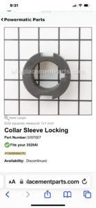

today it broke: Powermatic says the part has been discontinued and I can’t find it on Amazon or eBay. $18 part and I’m headed now to a fabricator.
It’s a locking collar sleeve to lock the spindle lock. Part 3097007.
Then I get the pleasure of trying to install it.
How, I’m sure several of us are wondering, can they discontinue a part from a lathe that’s still in production?
I think it’s a completely different piece since they had troubles with the 3520a spindle lock. If the same, they should have told me it was compatible when I called Powermatic, one would think.
but I’ve got a solution thanks to this site. Can get this piece cut down and modified.

my guy fabricated the new spindle lock but today, instead of just installing it, we took motor and VFD off to take headstock off. He took it to his shop where he will replace bearings and belt, install an rpm tachometer as well as placing the new steel (not cast iron) spindle lock. 3520a VFD just gives a number and you convert via a chart to rpm—a real pain. It’ll be a new lathe! New one on the right. Will be much stronger. Look at all that rust where headstock sat—naval jelly and some work took it all away. IMG_3142.jpegIMG_3143.jpeg
my lathe wizard finished the tachometer and other improvements on my Powermatic 3520 a/b* but then offered something else—since my lathe is outside even with a custom cover he’s afraid motor and VFD may rust w rain. Rust on the rails is easy to remove but motor and VFD rust may be a real issue. So he’s making them detachable from the headstock. I will then just disconnect & bring the VFD and motor into the garage or house.
So I’ll have a tach to see rpm, a steel spindle lock that locks every 90 degrees with 2 set screws (he modified it further after the picture I posted), new bearings, new belt, spindle remachined smooth, and detachable motor and VFD.
