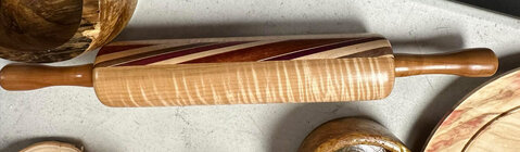

This isn’t a pepper mills, but similar idea.
the normal way to prep for gluing is to run them thru a planer, jointer, or thickness sander. Some people use all three. Problem is, I don’t have any of these tools, and would not use them enough to justify buying.
