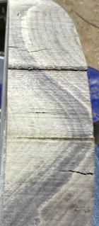

Rough turn them and seal them right now. Sealing only the end grain on those chunks now will have a very low probability of success. Been there.
example of rough bowl sealing below. Marking a green weight will be helpful later on.
