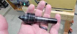

My PM comes with a cheaper live center. No pin to remove or replace. Perhaps the LC you are associating with PM is one that comes with older or larger machines.

If that was what PM supplied, it certainly ought to be replaced. For the money they charge for any lathe, they ought to provide a better LC.

If that is the stock one, then any of the others mentioned will be an upgrade. Most of them have a 60* cone like you have, but it will unscrew from the center, and allow a ton more flexibility. If you are on a budget, check out the one from Penn State.

Well have a look at the photo, its not the live center you thought the PM would have....
