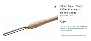

Thanks. By “continental “ do you mean the grind on a bowl gouge or is there a continental roughing gouge
I mean the continental spindle gouge
It is a gouge forged from a flat bar. Difficult to use without a solid schooling in the fundamentals.
Shallow flute in the proper hand it roughs like a dream.

Thanks for your help. I've got quite proficient with a 10mm spindle gouge: less sure about 30mm! Though I can see there's not too much difference between it and a big roughing gouge though I suspect it requires better control!

Difficult for me to tell flute shape in the gouge above. The Continental style have a ) shaped flute. The traditional SRG is closer to half round shape. The old bodgers, green spindle turners used to prefer the continental type gouge for their work. Hmm, spell check doesn't know what a bodger is........

I’ve seen the Sorby Roughing gouge at uk 84 which put me off a bit! But Hamlet who I think are linked to Henry Taylor have a more modest priced one. I’ll have a look on eBay but either they are included in a load of tut or only 1” wide (so far- I’m in no rush as it’s 47* in the garden/ shed/ workshop- unheard of for the UK!)
