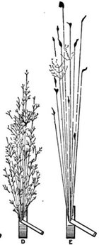

Brian you can tell if the steel is high carbon steel or HSS by testing what parks you get from the steel when grinding on a regular grinder wheel.
The high carbon steel gives a forked spark that kind explodes , while the HSS has much redder spark without all the exploding trails.
Kind of like in this picture, the left one is high carbon steel.Spark_testing_.jpg
Kind of like in this picture, the left one is high carbon steel.View attachment 51699
Interestingly, the “more modern” appearing one I ground today hardly made any sparks, and took FOREVER to ground into a bedan style. The one I did the other day looked like an older lathe tool steel, sparked much more, didn’t take quite as long to sharpen and the tip turned blue easily, so I’m assuming that one might have been high carbon steel and today’s some form of HSS.
But I didn’t notice the form the sparks themselves took.
Probably one of the cobalt carbides (eg tantung or stellite), you won't get much of a spark off those, or it could also be one of the tungsten carbides. If so, it may not take the sharpest edge but should have good endurance.
