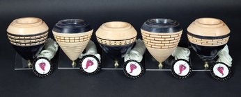

I make a lot of tops, usually stained with Craft Supplies Artisan or Chroma Craft, followed with sanding sealer and Ren-wax. No complaints so far, but most of these are going to adults and late-teens.2021_SpinTop_49_53a.jpg
