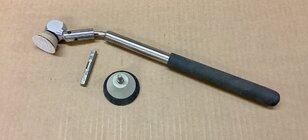

Here are my thoughts on sanders. When I started turning, I bought a couple of the angle sanders. I hated them. There were three problems. First, the noise was unbearable but that was reduced with ear plugs. Second, holding the hot and vibrating drill was really hard on my hands so I ended up wearing heavy gloves. After sanding a bowl, my hands really ached. And third, because of the heat, dust and vibrations, the ball bearing seats melted and the drills ran rougher until they died.
My solution was as follows. I had lost faith in my sump pump and bought a new one. I took the old sump pump motor (unfortunately it's 1750RPM) and mounted it on a board and hung it from the rafters. See the photo below. When hanging, it was essential to insulate the motor's vibrations with a bungee cord. I bought a five-foot long flex drive with a drill chuck on the end. Using it is a lot easier than with the hand drill. I use the tool rest to anchor the drive although Robbo Hippy's articulated rest might be better. The flex drive is the weakest part and if you sand gently they last for several years. Also the 3" pads are much harder on the flex drive than the 2" pads. I've initially used the sump pump switch but then switched to a foot switch and I'm now using a light switch mounted above the lathe.
In the photo you can see my velcro strips that hold my sanding discs. Depending on the wood, I can use them a couple of times before they are tossed. Since I normally turn green to finish, I've found that the Abranet grits work great on green wood since I can blow out the particles that fill in all the holes.IMG_5312.jpeg
