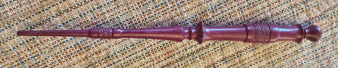

All this said, almost 30 years ago I bought a small quantity of purpleheart blanks and boards from a gentleman who was selling everything after his father passed away. Unlike other purple heart I have, that stuff, for some reason, REFUSES to turn brown. The guy I got it from said his dad brought it from somewhere in Mexico, didn't know where. Is there a special place in Mexico where wood keeps it's color? Could it be something in the soil, perhaps from something (or someone) the Aztexcs buried?
So far, I can't tell if the color on this has change a bit. (Not the best photo) I'll check back in 5-10 years.
