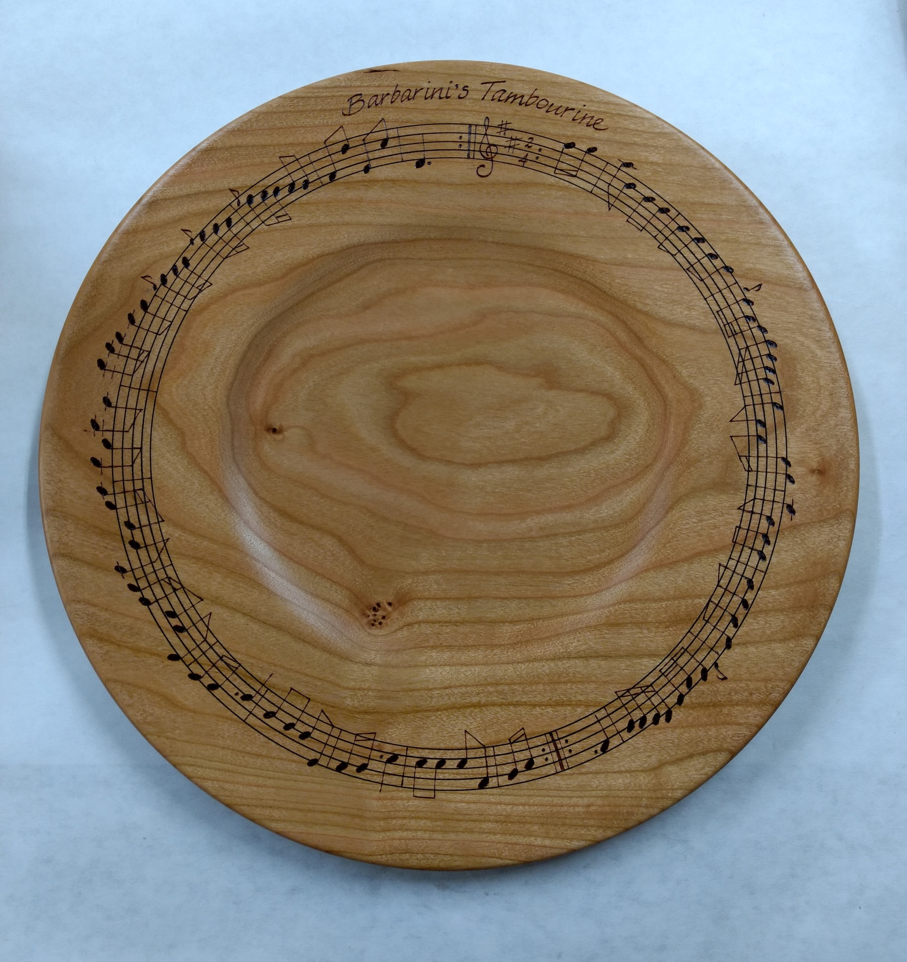

I have used a Colwood Detailer woodburner for many years for signing my pieces, and I use the RT-C tip (https://woodburning.com/collections/replaceable-tips-rt) for anything that involves handwriting. On my pieces with a milk paint finish or very finely polished surfaces, I use an inexpensive engraver.
The title on the musical plate was done with the RT-C tip, as an example...

Thanks for the photo and all the advice. You all have given me plenty options.
