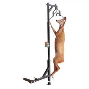

Weld or bolt a receiver to your lathe stand and get one of these.
I'd knock off some of those limbs with a chainsaw before I put that deer on the lathe.
