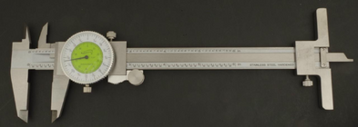

I've purchased this dial caliper, because I want the convenience of reading fractions directly on the dial......instead of having to use a chart to convert decimals to fractions.
Curses........I might just have to buy two of these! :)
I opted for the depth gauge attachment to be included....
