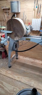

I have a pivoting headstock lathe. It locks down tight. I think it will handle anything pivoted that it will lined up with the bed. Mine is able to turn 39” outboard. I have not done anything larger than around 22” but it handles that with no problem.245D377E-B5CA-4724-8115-D49715BC4832.jpegE56AE0C9-351E-4C7D-82F2-A59A3CCF4CB3.jpeg
