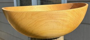

Absolutely not. Walnut dries incredibly easily, but if you include wet sapwood or crotch figure, there is no predicting the wood movement. I once turn 18" soft maple bowls all the time, with little to no loss.
