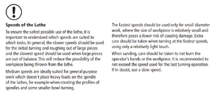

I have never seen anything like that from other suppliers, not saying I checked all manufacturers. Axminster Evolution i.e. have nothing of that rubbish. Their cautioning is quite good:
Safety instructions for chucks
When using this chuck please follow these basic safety precautions:
DO ensure the chuck is screwed fully onto the headstock shaft.
DO ensure that all accessory fittings are secure before starting your lathe.
DO start the machine in a slow speed if the work is unbalanced.
DO make sure the chuck key is removed from the chuck before switching on.
DO be aware that when gripping large diameter workpieces that the jaws may extend beyond the boundary of the chuck body.
DO keep your hands clear until the chuck has stopped rotating.
DO NOT attempt to exceed the normal capacity of any jaw fitted to the chuck as the jaws may not fully engage the scroll if they are extended too far.
DO NOT run your lathe in reverse, unless you have purchased the Reverse Locking Chuck.

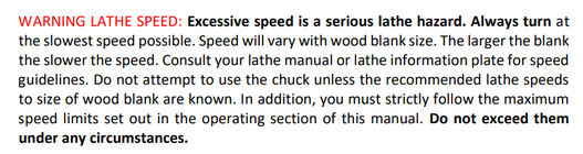

I've been looking through the Nova G3 chuck manual today, to make sure I'm reassembling my chucks correctly. Noticed this:
"DO NOT EXCEED THEM UNDER ANY CIRCUMSTANCES."
Seems to give weight to what the OP said... If these very low RPMs are really that critical of a speed limit for Nova, that makes me highly suspicious. Their speeds are pitifully slow, well below speeds frequently recommended by most of the world's top turners as far as I am aware...
It is widely believed by smart people that manufacturers include totally impractical statements for liability purposes. They HAVE to say that or someone will sue them and win.
I know of NO good turners who obey these orders to the letter. I know of no good turners who suffered anything by working differently. A good dose of wisdom goes a long way: they turn at the speeds appropriate for the equipment, the work, the wood, the weight and balance, the skill/ability, any distractions present, and the level of alertness.
