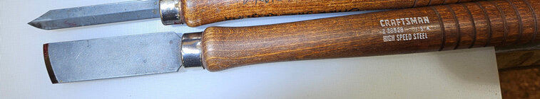

When I started woodturning the skew figured heavily as most of my work was spindle based. I have a selection of sizes but all have a straight skewed edge sharpened to 40 degree inclusive angle (20 each side) on a pro edge ceramic belt and honed on a diamond stone. I don't use skews much during the majority of the year as I now do mostly "faceplate" work. The skew is brought out for Christmas ornaments and I try to do as much of the project as possible using the skew. Colwin Way is my inspiration for many of these projects and he is now selling his "Signature Skew Chisel" through Axminster tools. It is a German style splayed skew like the one shown by Bill Alston in this thread on Aug 12 '25. He says the advantages are:
  • Easier to handle, flared tip counterbalances the handle
  • Shorter handle gives greater level of control
  • Design results in more sensitive feel when making planing cuts
  • Rolled edge glides along the tool rest smoothly
  • Chisel rolls evenly when cutting beads
I might ask Santa to drop one down my chimney when he is passing so I can try it out!😉
Just an opinion but I think the German design is from way back when a smith forged lathe tools. He started with a square piece of steel and flattened the business end and the narrower end was drawn out to lengthen the tool and fit in a handle.
I ain’t no blacksmith but it’s my story and I’m sticking to it.
