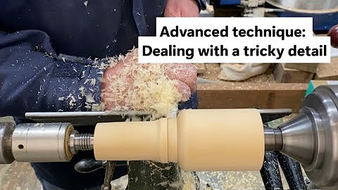

You certainly can strop and hone skews but you definitely don’t have to. I use mine straight from a 180 CBN, and Steve Jones (until he recently also upgraded to 180 CBN) used to use his straight from an 80 grit stone. So yes, skews absolutely must be sharp, but don’t get hung up on it, get on the lathe and practice.
I have a playlist on the skew on my YouTube that you might find helpful:
Richard
