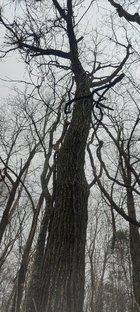

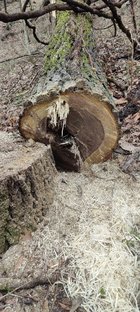

This isn't exactly a project, but I figured I'd take you on my Sunday journey. I found a tree behind the house that Picture This identified as a butternut. Picture This has a hard time differentiating walnut and butternut, but I decided to cut it down and see.

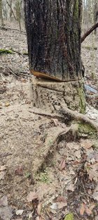

The tree is 20" diameter at the base. My chainsaw is 16". It was a lot of work.
Step 1, Fell a Tree
No comments on my chainsaw skills, please. ;)

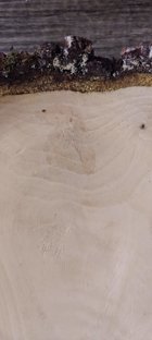

That last picture sure looks like walnut.

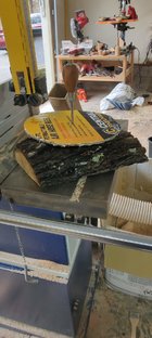

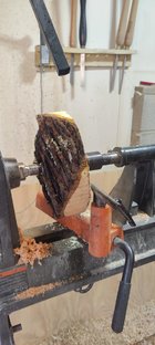

Taking advice from someone here (sorry, don't remember who), I cut one side thicker than the other. I decided to turn the smaller (skinnier?) side first. It's the one on the left.

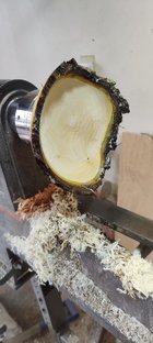

Make it round and mount it.
I use the spur center a lot.

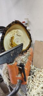

Step 3, Turn a Bowl

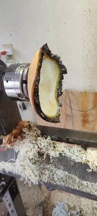

I forgot to get a picture after I completed the outside. I subscribe to the "leave a mass in the center" philosophy when turning the interior. Why? Less wing flex, among other things.
A lighting artifact makes the outside look like a different color. I think the light on that side is set to a warmer tone.
Ready to start drying. It's very wet, of course, so it will take a bit. I microwave dry most of the time. Should be dry in the next couple of days, though. Starting weight right off the lathe is 303 grams.
