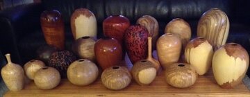

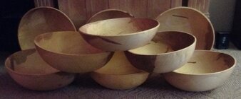

All of these were turned from a tree cut days before. Not a crack in the batch. In the 38 years of turning, the only time I have twice turned is some cremation urns so I could get a round hole for a threaded insert. ALL the other work is once turned green wood. You must consider species, drying techniques and even and identical wall and base thickness. The stack of salad bowls are 18” in diameter.
