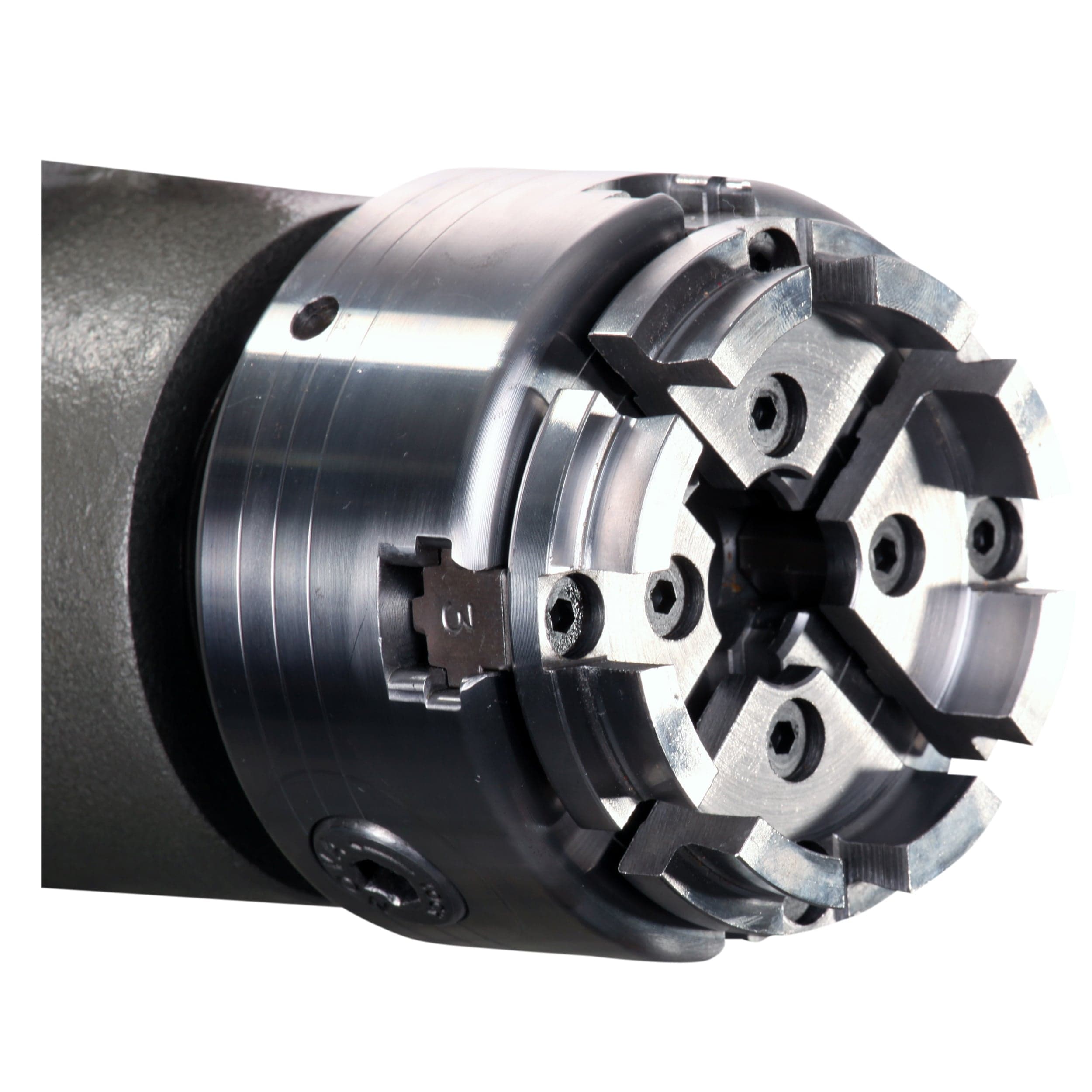

Maybe I'm being thrown by how these look, is this what you are referring to:
I guess its the upper screw slots that make these look a bit unusual...the screws apparently need to thread in dead center to the jaws, so the jaws have been split.
I was kind of thinking, for long blanks, even with a steady rest, a longer tenon might help provide additional stability...but, I honestly don't have enough experience there to know.
I have never used them, but no, I don't think a longer tenon will provide more stability. Imagine the chuck sitting on a bench, with jaws up. Talking tenons, typically the jaws contact the work piece along the top surface of the jaw profile and on the inside of the jaw contour, which may be dovetail, or in the case of Nova/RP, bird beak. The tenon itself need only be 1/4" long, and you absolutely don't want the tenon to bottom out in the jaws. All of the hold is created by the 1/4" surface at the top and 1/4" surface on the inside of the jaws. If the tenon were longer (but did not bottom out), it would have contact with the sides of the jaws, but these are smooth and contact here would keep the dovetail for getting a good hold. Also at a certain point the wood itself becomes the weak link and the tenon breaks because of an internal defect, etc.
That was probably clear as mud. I think others can explain it better.
Yup, that's just the compromise to get two screws into the jaws. Works to your advantage if the tenon is larger than the perfect circle as you have 16 corners digging in rather than just 8.

I don’t know if I can add to the above comments. Do you have the Nova 50 mm jaws that have the lip at the end (birds beak)? and did you cut your tenon straight (not dovetail)?

I still believe it is the tenon causing the problem. The tenon for the Nova 50mm jaws needs to be cut straight. There are some that believe you need to make a cut for the “beak” at the top, but IMO it is not necessary and not recommended by Nova for those jaws. At this point I believe as previously suggested that you remove that tenon. and put a faceplate on the piece. That will tell you if the chuck or tenon. was the problem. As far as truing the outside without any problem I suspect you are applying less side force cutting the outside verses scraping the inside. If you do use a faceplate, take a picture of your tenon before you remove it.
I did remove the tenon, and I did put on a faceplate, mentioned earlier in the thread. I didn't grab any pictures before I did, sorry. The faceplate actually got the piece fairly close to true, but when I tried to start hollowing again, things shifted and it was out of true again. I re-trued the outside two more times, before finally deciding to give up on the piece. FWIW, I wasn't actually scraping the inside...I never got that far. I was just trying to shape the top, which is pure endgrain. I was using a spindle gouge, so making cuts, rather than scrapes...
