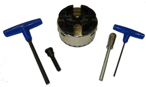

I’m thinking about getting a Vicmarc chuck the vm100 can I get it with direct thread. 1 1/4 by 8 or does it only come with an insert
And do these ever go on sale anywhere
In the USA. Thanks
1,365
3,940
Hi Tom, the the vm100 does come with a direct thread option. This is from vicmarc’s site:
I’ve been on the fence about getting a vm120 for a long while. The biggest sale I’ve seen in months of watching is 5% off. So, I’d suggest you just bite the bullet.

Might as well go full Cadillac. Take a look at vm150. 11.7 pounds of take no prisoners. Fits any vm120 jaws giving it a very wide selection. Does require a spindle specific insert. Maybe it's all in my head but the lathe seems smoother somehow.

I have a vm120, direct thread. I do really love my Vic. It's a beast that has never let go. I kinda wish it were insert instead so I could install a grub screw without affecting the chuck body. Plus, you never now when you might want to use it on a lathe with a different spindle.
I don't know what lathe you have, but a big chuck (like a vm150) might not be the best thing for a mini or midi lathe.

I find the quick release on the 150 to be irritating and of no benefit I've yet discovered. My 120's handle everything I've thrown at them (bowl blanks up to ~25" in diameter) and is a lifetime purchase-- the jaws for the 100 don't work on the 120/150, so won't transfer when you upgrade. I'd spend the extra for the 120 and only feel the pain once.
I've been seriously thinking about selling the 150 and getting another 120 in its place.

I was thinking that the 100 would be better for small work like pens wands and ornaments
I agree with that statement To some extent. you can of course hold small work in a large Chuck.
but sometimes the smaller holding devices work well.
collet chucks are evern smaller and can hold a finial well.
depending on the jaws and your turning style the smaller chuck will let you do things like undercut a goblet base without rubbing the chuck with your tool. However taller Jaws on a larger chuck gives more clearance and adding a 1/4” to the waste will solve the clearance problem Too.
there is also the comfort factor. Smaller chucks can be less intimidating for newer turners.

VM100 vs VM120.
The Jaw sets on the VM100 are less expensive. However, the number of jaws available for the vm100 is much less. When you buy the VM120/150, you're buying one of the most extensive jaw lines of any woodturning chuck manufacturer, covering most chucking situations. Youll never know what you may be turning in the future. The VM120 line is a good solid investment. If I were to own only one chuck, it would be the VM120. I own both the 150 and the 120 and of course, many more manufacturers. I've never had a Vicmarc handle break, but if it did, it can be inexpensively replaced by a hex key from your local hardware store.

I'm in Canada; I went to order a VM 120, and Ken, the Canadian dealer, called me (right away) to make sure I was ordering the right chuck. My lathe is a General 160 with only a 12" swing; he strongly suggested I get the 100 rather than the 120. So I did, and have been very happy with it. Will be ordering a second one soon. It certainly seems capable of handling anything I can do on that lathe.
