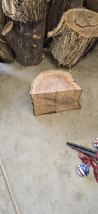

Grabbed 3 BIG chunks of this from the wood pile at the recycle center. I am no arborist, so unless I know the actual source of the wood, can see the leaves, or it is REALLY obvious sometimes I can't tell.
Anyhow, phone app says cherry. We don't have a ton of cherry around here (or if we do it gets grabbed up quick from my source) but wanted some opinions.
thanks all!
--Scott
Yep! Took these pics when I got home after I salvaged these. Anchorseal since applied 👍 Cracks don't look like they are too deep so hopefully will be worth turning.

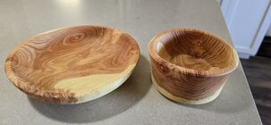

I cannot be sure the tree pieces are all from the same tree. I snagged them at the recycle center near each other, but there is no way to know. 100% of the what I KNOW to be honey locust I have found locally and turned has bark that looks like this image (Googlefu says this is thornless HL) - lots of texture and channels in the bark.
And the ring lines are tight and confined to the middle of the wood, not broad and spread out like the image I shared in the post. Here are two pieces I have turned:

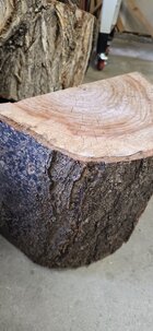

Here is another look at the bark of one of the other pieces:
What's funny, is I can find internet images of other locust varieties AS WELL AS cherry that match this bark exactly, so it is well within the realm of possibility it is a HL but a type I have never come across before - I've only been turning 8 months!
