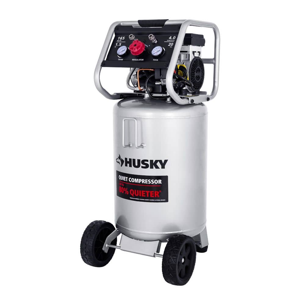

Greetings Paul. You can get a 20 gallon Husky at Home Depot
I have the 4.5 gallon version and it's very quiet
I have this 20 gallon. It was perfect and quite quiet (in the grand scheme of things) until earlier this year. In general I think its a good air compressor (it replaced 4.5 gallon Husky that I had originally.) I've had mine for...three years now? I ran into a problem (which I may have posted about on these forums) with the regulator. It started to leak from within the regulator. I took the regulator apart, cleaned it, thinking that was the problem, but the problem persisted for a while. I tried adding some thick lube to the bladder, to see if that might help seal the interface. It eventually stopped on its own, just before I bought a replacement regulator (have to replace the entire part, which I'm not even sure I found the right one, actually). Occasionally I'll hear a hissing, and its air leaking from the regulator. It does not occur much anymore, but, its kind of an annoying problem as it results in the air compressor running significantly more often than it usually does when it occurs.
I don't know if this is an issue just with mine, perhaps due to some kind of unintentional mishandling or something, or if its a design problem. Outside of this issue, I thought the compressor as a whole was really nice, the quiet factor was nice (I mean, its around 70dB, which is quieter than the 85-100dB you get with most compressors, but not exactly "quiet" per-se), and having the larger reservoir is nice as (without my problem with the regulator) you could go quite a long time between recompression cycles. For the money, I thought it was a good deal. The regulator issue does not occur very often now, and it may well just be a weird fluke. But I thought I'd mention it. Barring that issue, I like mine in general. I've also used it for painting my house with an air gun and painting some other things. I use it for winterizing my sprinklers (its borderline for that, but it does work), etc.
Hi Ed, happy Thanksgiving! I actually bought the California air compressor version of the husky. Except 10 gallon and 2hp. Only had it for a week so far but I’m very happy with it. Lot quieter than the 1.5 gallon husky i bought several years ago when i was taking upholstery classes.
